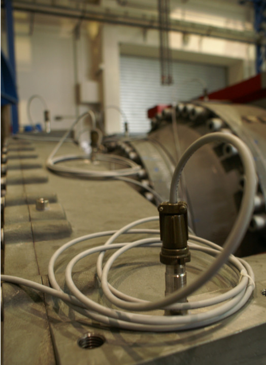

The ZKL CMPM is formed by 2 elements – diagnostic unit installed at the customer and ZKL sever. The data are continuously send and monitored by the ZKL Research & Development diagnostic department. The specialists analyze the ability of competent operation until next planned interruption of operation, recommend eventual maintenance, grease refilling, balancing of the machinery etc. The unit normally executes scanning of vibrations and temperature of the bearings. For more demanding applications it could be enriched with more functional and processional quantities. The communication between unit and server is realized via internet connection.

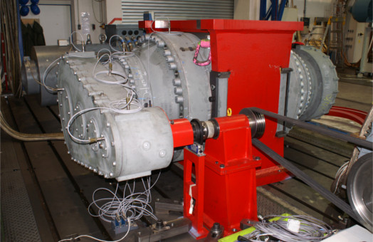

At the moment the system testing in real operation of our industrial partners is held. The examinations of diagnostic unit form part of the project for optimization of a gearbox construction for jack-up of oil flats. The diagnostic unit is verified during the lifetime test of the gear unit. With its assistance the condition of all bearings set made by ZKL Brno and ZKL Klášterec nad Oh?í is monitored. Acquired data will serve for optimization and development of gearboxes for our customer and ZKL bearings. So it would help in following progress of ZKL CMPM diagnostic unit.
