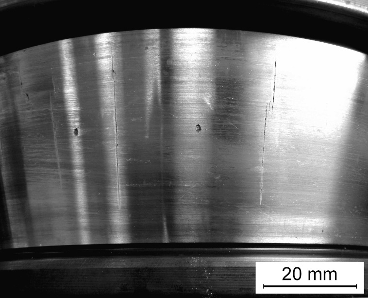

Bearings in industrial, e.g. wind turbine, gearboxes quite often suffer from a significantly shorter life than calculated by so-called white etching cracks [4]. These early failures are characterized by mostly axial raceway cracks, revealing vertical semi to fully circular cleavage-like lenticular brittle spontaneous incipient cracks in preparatively opened original fracture faces. Occasionally, pock-like spallings are associated with the surface cracks, as shown exemplarily in Fig. 2 [5]. The developing deep crack systems are open to the raceway, from which oil penetrates and promotes further corrosion fatigue crack growth as well as local secondary microstructural changes in the form of crack path decorating white etching constituents. It is evident from fractography and X-ray diffraction (XRD) residual stress analyses that the cleavage-like incipient cracks are caused by frictional tangential tensile stresses, which occur in subregions of the contact area in vibrationally induced mixed friction operating conditions.
Fig. 2: Inner ring raceway with typical axial cracks and few associated pock-like spallings.

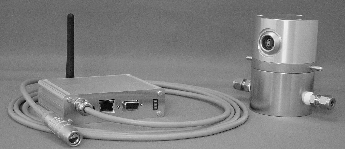

Following authentication, a simple web browser permits access via the wired or wireless LAN. In case of alarm signals, an immediate automated generation of warning messages, for instance by e-mail or SMS, is possible from any computer with Internet connection. Fig. 6 shows the OilQSens® sensor system with communication module [9].
Fig. 6: OilQSens® sensor system with communication module.
