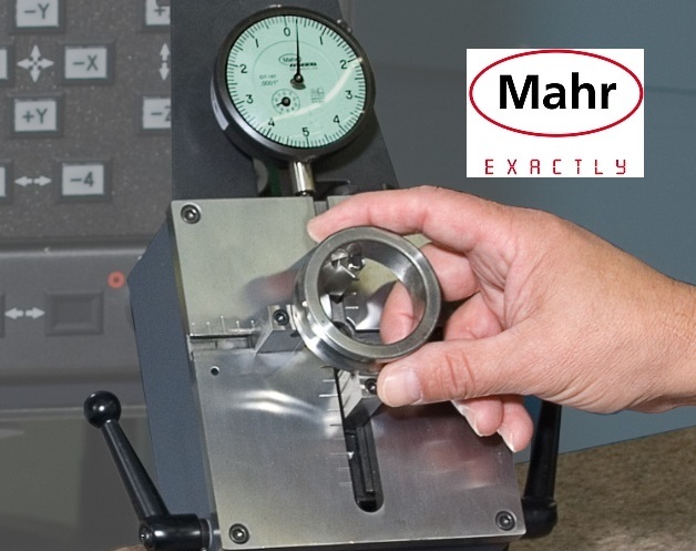

PROVIDENCE, RI — A versatile bench-mounting indicator gage available from Mahr Federal provides a handy and economical way to measure IDs and ODs right on the shop floor. Available in both T-Plate and V-Plate styles and in two sizes, the 36 B ID/OD Indicator Gage can measure inside diameters from 0.75″ to 9″ and outside diameters from 0.25″ to 9.5″. The 36 B comes with either a dial indicator, Maxum® III, or µMaxum indicator, and a number of different jaw sets and contacts.
MahrFed36BWeb“The 36 B is a real work horse,” said George Schuetz, Director of Precision Gages for Mahr Federal. “Fast, accurate and easy to operate, the basic design has been proven in many shops over many years, and with a Maxum III or µMaxum indicator, digital measurement data can be output directly to any computer.”
The T-Plate configuration gives a diameter reading directly across the diameter (a third contact may be used as a side-stop or centralizer), while the V-Plate configuration is self-centralizing. Frequently used to inspect parts with odd number lobing conditions, the three “V” jaws measure the distance between the sensitive contact and the chord formed by the two reference contacts. This measurement bears a direct relationship to the diameter, and compensation is made by a special ratio indicator so diameter is read directly.
The 36 B ID/OD indicator gage features adjustable contact retraction which allows for the measurement of grooves and races. Frictionless reed-spring motion transfer facilitates repeatability, and gaging pressure is adjustable from 0-35 N/ 0-8 lb.
The gage can be positioned at any angle from horizontal to vertical, and simply reversing the top-plates changes the measurement from ID to OD. The 36 B ID/OD Indicator is supplied with JW-9 jaws, but special spherical contacts are available in steel and tungsten carbide. Doughnut shaped contacts as well as TC Ball and Pie Plate contacts are also available.
