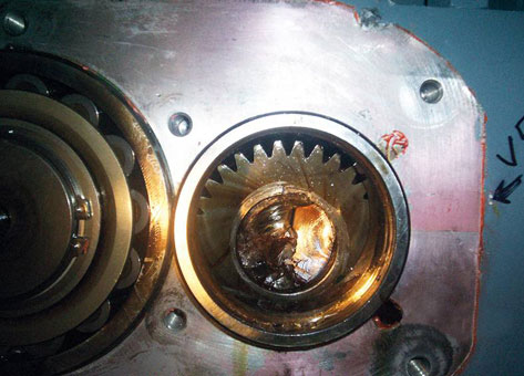

Forced fractures, for example, are often caused by malfunctions, seizures or overloads. Fatigue fractures and cracks can be caused by impermissible load vibrations or disturbing vibrations. Typical fatigue fractures or forced fractures in a universal joint shaft are shown in Figure 1.
pruftechnik-cnt1
pruftechnik-sl
pruftechnik-cnt3Fig. 1: Several damage patterns on machine components
