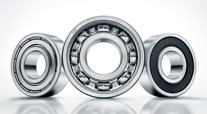

Schaeffler’s standard deep groove ball bearings set the benchmark when it comes to relevant technical characteristics, such as minimising friction and noise. Reduced friction means, for example, lower energy costs during operation.
Schaeffler products continue to set benchmarks when it comes to important technical characteristics such as minimising friction and noise. Two new sealing concepts have also been developed. Reduced grease loss and better protection against contamination extend the grease operating life and therefore the operating life of the bearing. The new Z-type dust shield with its innovative labyrinth seal, helps to reduce grease loss by 20%, and reduces contamination by 30% compared to the previous design. The patented ELS lip seal (optional) provides maximum sealing at low friction and is particularly suitable for alternating axial loads, such as those found in the wheel bearings of motorcycles. This improved sealing, without any additional friction losses, is due to the innovative shape of the lip, which is perfectly matched to the ring recess. Furthermore, the recesses have now been moved to the interior of the bearing, significantly improving its robustness during handling and mounting. In addition, non-contact BRS lip seals and HRS lip seals, which start at the inner ring, are available with increased sealing performance in the standard range.
The high quality of the balls and a noise-optimised cage enable Generation C bearings to run at significantly reduced noise levels compared to conventional deep groove ball bearings. Also, optimised osculation reduces friction. These characteristics can be attributed to numerous improvements to raceway parameters in terms of roundness, waviness, roughness and tighter manufacturing tolerances. Reduced friction also means lower energy costs during operation.
Various sealing concepts in the standard range for different requirements (from left to right): Open bearing, gap seal on both sides (2Z), lip seal on both sides (2HRS), lip seal on both sides (2ELS), non-contact seal on both sides (2BRS).
