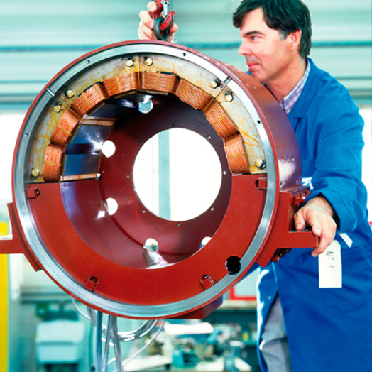

The radial magnetic bearing stator comprises electromagnets, usually made of a stack of laminations with copper coils wound around the north and south poles. A current is applied to each coil to produce attractive forces on laminated iron rotor parts so to levitate the shaft inside the bearing. The clearance or magnetic air-gap between the stator and the rotor is 0.5 to 1.0 mm, depending on the application, thus there is no contact friction, no component wear and no lubrication required. The axial bearing design is similar but with solid iron stator cores and rotor parts, rather than laminated.

SKF proprietary position sensors accurately measure the radial and axial displacements of the shaft. For light rotating machines, a “sensor less” solution is provided, combining the sensor and the electromagnet in a single stator. The power electronics have digital control to supply the currents to the electromagnets and keep the shaft at the pre-defined position. The digital control provides optimized stiffness and damping and with specific functions such as automatic balancing.
