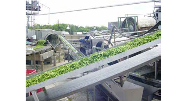

Hanover Foods operates a green bean line that was assembled on-site by the Hanover maintenance staff many years ago. Various sized bearings are found throughout. This system consists of a vibratory belt system manufactured by Key Technologies, a conveying belt system manufactured by Hanover, as well as various bean washers and bean snippers manufactured by Hughes. This bean line constantly washes the green beans while the snippers remove any stems from the bean prior to entering the main building for further processing.
The bean line not only operates in the harsh environment outside the plant, but is also under constant water wash down. It operates 24 hours a day, 7 days a week from the end of June thru September.
