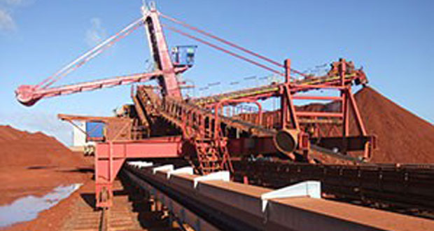

The paddle-wheel stockpiling unit at the AOS open-air storage facility reaches impressive dimensions. As part of a general overhaul its energy supply system was modernised.

The Aluminium Oxid Stade GmbH (AOS) is one of the major alumina producers in Germany. It processes the raw material bauxite into alumina of high purity which is then sent to the processor. More than one million tonnes of alumina are produced every year in Stade. For this, one needs about double the amount of bauxite, which the deep-sea vessels bring from Africa, Australia, and South America and deliver at the AOS’ own harbour. A single ship delivers up to 70,000 tonnes of raw material that is transported further via an enclosed conveyor belt system for temporary storage. The different types of bauxite are either stored in warehouses or large open spaces and fed by an impressive, highly visible paddle-wheel stockpiling unit of the production (Figure 1).
