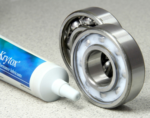

Krytox® AUT 2E45 grease has been field tested and proven as a ‘lubed-for-life’ solution for
ball bearings in industrial electric motors at a pulp and paper production facility, as well as in other industries with similarly harsh service conditions. Photo: DuPont

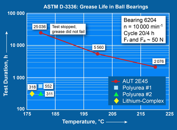

Comprehensive comparative testing was carried out between of Krytox® AUT 2E45 and industry standard motor greases. The results clearly demonstrated the superiority of Krytox® – lasting up to 64 times longer than ordinary greases in elevated temperature testing (see graph). On the basis of these results, Cariboo Pulp & Paper began fitting fully sealed bearings prefilled with Krytox® during their routine motor overhauls. Since the program started seven years ago, not one of these electric motors has failed due to problems with the bearings.

Laboratory results from ‘ASTM D-3336: Standard Test Method for Life of Lubricating Greases in Ball Bearings at Elevated Temperatures’ clearly demonstrated the potential for a truly ‘lubed-for-life’ solution for industrial electric motor ball bearings. In the accelerated life test, Krytox® AUT 2E45 retains its excellent lubrication effect over the long term when compared to industry standard electric motor bearing greases.
Graph: DuPont
