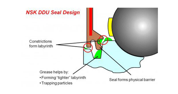

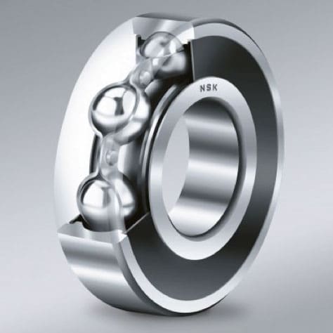

The obvious solution was to recommend the use of NSK Deep Groove Ball bearings with the high performance DDU sealing arrangement, these bearings are designed specifically for use in dusty environments and employ a face riding contact seal with a grease return feature on the inside surface of the seal. They also incorporate a shoulder on the inner ring and an additional debris trap on the outside.
NSK DDU seals give improved seal performance particularly when compared to traditional ´2RS´ seal designs which only seal against the smooth cylindrical surface of the inner ring shoulder or at best against a recess in the inner ring side face. The DDU design keeps particulates at bay and effectively protects the bearing grease in a dusty environment.
