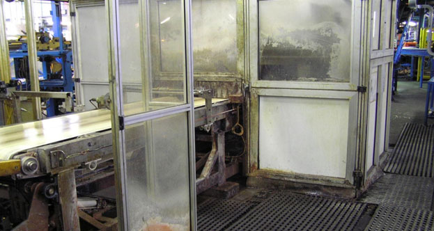

Water spray generated by the tyre cutting process is known to shorten the service life of standard ball bearings deployed in such applications. However, at this particular plant, the problem was exacerbated by inadequate protection at the bearing locations. As a result, the maintenance team was faced with replacing the bearings prematurely, typically twice a year.
This was in addition to an average of two unscheduled stoppages per annum due to catastrophic bearing failures and line stops.
Within the framework of its proven AIP Added Value Programme, engineers from NSK visited the plant to see the application first hand before analysing the bearings at one of its technology centres. There, it was confirmed that the principal cause of bearing failure was the ingress of water from the rubber cutting process. As a consequence, NSK determined that the optimum solution would be the adoption of stainless steel mounted units with Molded-Oil inserts.

Since putting NSK’s recommendation into practice, the tyre manufacturer has witnessed four times greater service life from each bearing unit; the bearings are now replaced only once a year instead of the three month cycle endured previously. When assessing lost production time and the cost of replacement bearings, the annual net savings from using Molded-Oil pillow block type bearings with stainless steel housings was calculated at €119,000 per year.
