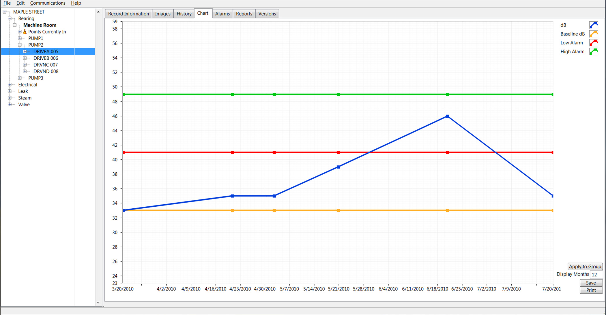

Drive bearing lube history
Drive Bearing Lube history:  This chart shows a trend of decibel readings taken on a drive bearing.  The readings are plotted against a baseline dB, a low alarm dB, and a more critical high alarm dB.

The first step is establishing both a baseline decibel level and a sound sample. This is ideally done when moving through a route for the first time by first comparing dB levels and sound qualities of similar bearings.  Anomalies will be easily identified.  Once established, each bearing can be trended over time for any changes in either amplitude or sound quality.
Generally speaking, when the amplitude of a bearing exceeds 8 dB and there is no difference in the sound quality established at baseline, the bearing needs to be lubricated. To prevent potentially disastrous over-lubrication, the technician will then apply lubrication, a little at a time, until the dB level drops.   Many departments set up their “Condition-Based” lubrication programs by incorporating a two- stage approach.  The reliability inspector uses a relatively sophisticated ultrasound instrument to monitor and trend bearings.  A report of bearings in need of lubrication is produced.  The lube tech then uses a specialized ultrasound instrument that alerts the tech when to stop adding grease. (These instruments can be affixed to a regular grease gun or worn in a holster.)
To improve efficiencies, it is a good practice for the technician to note when the equipment was last greased and how much grease was used to calculate roughly how much lubrication is used per week. By using ultrasound to lubricate each and every time, the technician produces historical data that can be used as a guide from previous calculations, helping the department to determine whether the lubrication schedule can be modified, perhaps saving man-hours, and whether the manufacturer’s suggested lubrication amount is accurate (if less is needed, there’s cost-savings potential).
