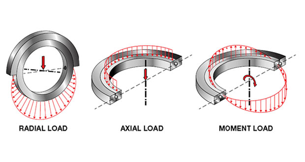

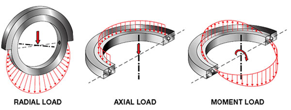

Radial, Axial and Moment Loads
There are three main loads to consider when selecting a bearing in any engineering application: radial, axial (or thrust) and moment loads.
carter-thinsection-cnt1
Figure 1: Three main loads to consider when considering a bearing type.
A radial load is any force applied perpendicular to the center axis of an object, an axial load acts parallel to the center axis of an object while the moment load is applied along the rotational axis, as shown in Figure 1. You can think of the moment load as any force that can cause an object to rotate. Normal radial single ball bearings aren’t designed for these moment loads so Carter Manufacturing Limited stocks a Silverthin™ product line specifically to satisfy these engineering constraints.
Moreover, imagine tightening a bolt with a wrench, as shown in Figure 2. The closer your hand is to the bolt, the more difficult it is to turn the bolt. Conversely, the further your hand is from the point of rotation, the easier it is to turn the bolt. This is because the moment force is defined by the product of the distance from the center of the bolt, d and the perpendicular applied force F, thus a bigger distance yields a bigger moment (while keeping the force constant).

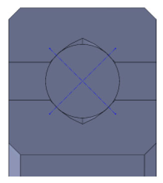

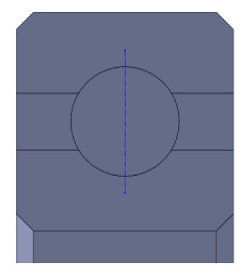

These “X-Type” bearings distribute the load at four points of contact, as shown in Figure 3. When compared to the conventional radial ball bearing raceway with only two points of contact, pictured in Figure 4, it is clear to see the difference in load distribution. An “X-Type” bearing can handle all three types of applied loads. This is particularly effective when only one bearing is used in the system, as shown in Figure 5.

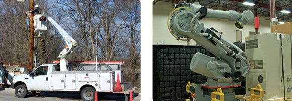

A simple example is a robotic arm that extends from a static base in order to pick up and rotate a load, shown in Figure 6. A thin section or slewing ring bearing at the base of the structure would experience this moment load. Therefore it is necessary to install a bearing capable of handling the moment forces.
