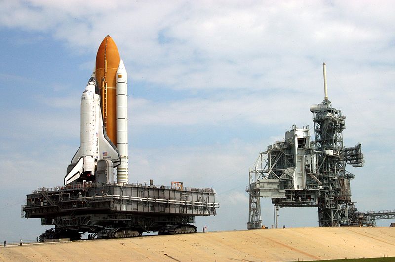

A crawler-transporter carrying Discovery travels the ramp to Launch Pad 39B.

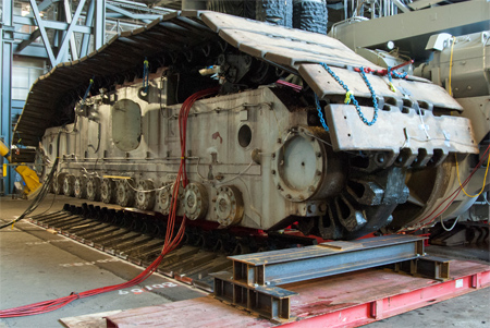

replacement of bearings on Crawler Transporter 2 at the Kennedy Space Center

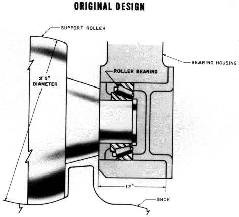

Initially, the nodes were supported by tapered roller bearings made from bronze alloy steel. Back in 1965, the tapered roller bearings could not stand the load of the platform during a test trip to the launching pad. The bearings could prevent deterioration of lubrication and heat dissipation, but failed to prevent the sudden destruction caused by the heavy loads.
Illustration: NASA
The original design of the bearing assembly on basis of tapered roller bearings have failed the test trials

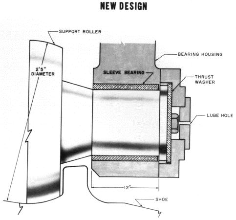

Revised bearing assembly on basis of the plain bearing
Difficulties with reduced friction and uniform distribution of the load on the body forced the developer of the roller conveyor back in 1965 to apply to the plain wheel bearings instead of tapered roller bearings
