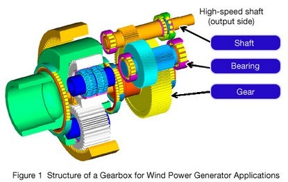

The gearboxes* for large industrial machinery such as wind power generators and mining machinery typically use cylindrical roller bearings in order to sustain the high load conditions of such applications. In recent years, wind power generators have increased in size in order to increase generation output. Also, mining machinery is used 24 hours a day, 365 days a year under severe conditions due to the advancements being made in emerging nations. For these reasons, bearings used in such large gearboxes require even higher levels of reliability.
In response to this need, NSK has developed a cylindrical roller bearing with increased load capacity for higher reliability in large gearbox applications.
* Gearbox: A device that converts input revolutions to the desired level of output revolutions through the meshing of multiple gears between the input and output shafts.
