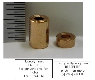

[ Features of the Hydrodynamic BEARPHITE ]
· Ultra-thin design with a bearing height of just 1.8mm
· Optimized hydrodynamic groove specifications and groove machining conditions to eliminate contact noise against the shaft when the fan is stopped
· New lubricating oil developed for further improvements to heat and moisture resistance
· Maintains a non-contact structure even under tough usage conditions, and offers a high level of silence and reliability
[ Product photo ]

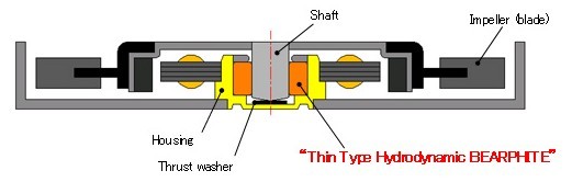

[ Cooling fan motor for Ultrabook PC ]
Cooling fan motor cross-section
