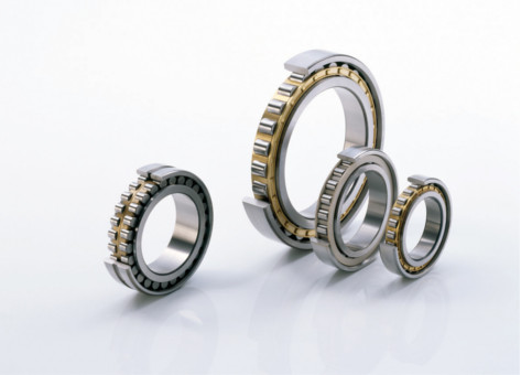

On the non-locating bearing side, the use of a cylindrical roller bearing offers significant advantages compared to other solutions such as angular contact ball bearings that are adjusted by means of springs. It allows a simple adjacent construction to be used and also ensures a reliable non-locating bearing function, as this takes place directly and without constraining forces in the bearing and does not have to be implemented using the housing fit. It also provides high radial rigidity. On the other hand, cylindrical roller bearings generally have a higher level of friction than comparable angular contact ball bearings, which manifests itself in the form of a lower limiting speed.
The friction in the rolling contact is principally affected by the preload. In cylindrical roller bearings, this is dependent on the speed and the temperature difference between the inner and outer ring. Centrifugal forces and the higher temperature of the inner ring cause it to expand to a greater extent than the outer ring during operation. This means that the radial preload of a cylindrical roller bearing increases significantly during operation compared to the setting made during installation.
FAG cylindrical roller bearings in the TR version have a flexible outer ring that significantly reduces the preload increase during operation. This means that the bearing is insensitive to fluctuating temperature differences and displays significantly lower frictional energy. The internal design, which features optimized friction behavior and a PEEK cage that is guided on one side of the outer ring, produces an optimized distribution of the lubricant and is suitable for high speeds.
The use of ceramic rollers as opposed to steel rollers also reduces the weight of the rolling elements and thus also the friction due to the lower centrifugal forces. What is more, the ceramic material’s lower coefficient of thermal expansion also means that the rise in the radial preload in operation is reduced, which leads to a further reduction of bearing friction. Because ceramic material does not tend to adhere to steel, the pairing of steel rings and ceramic rolling elements in hybrid bearings is tribologically more favorable than that of bearings with steel rolling elements. This leads to lower temperatures in the rolling contact and to reduced strain on the lubricant, and thus makes these bearings more suitable for high speeds while extending the operating life of the grease.
The use of flexible outer rings to reduce the preload that occurs during operation is also worthwhile in hybrid cylindrical roller bearings. Halving the number of rollers is another measure that can be taken to reduce friction in cylindrical roller bearings. This reduces the bearing’s load carrying capacity, but this still remains fully sufficient for the function it performs on the non-locating bearing side. The radial rigidity is also reduced; at the same time, however, the friction is reduced to 53% compared to hybrid cylindrical roller bearings with the full number of rollers.
