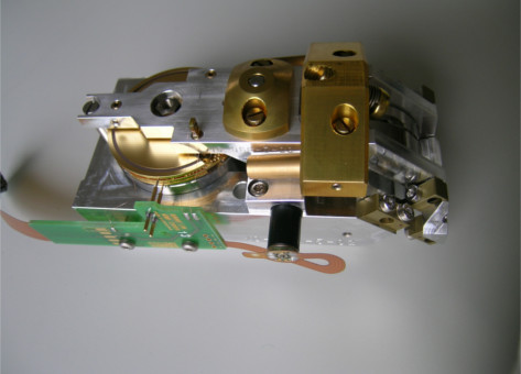

Picture 1: Grey mouse hides hi-tech at its best
In the 1970s the geophysicist G. Streckeisen began developing seismometers. He built instruments which set new standards of sensitivity. Streckeisen’s seismometer incorporated three balancing pendulums whose sensitivity was so high that even the impact of waves on the Atlantic coast were recorded as far away as Switzerland. Since 2010, two employees have continued to run the company: the mechanical engineering graduate Lutz Wiesner and the electronics engineer Robert Freudenmann.
As many electronic and mechanical components had been discontinued by component suppliers, Wiesner and Freudenmann had to develop new prototypes. Using Streckeisen’s proven principle of three pendulums and a feedback system, in conjunction with modern components, they built an instrument that seamlessly followed its successful predecessor.

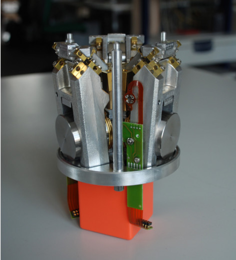

Picture 2: The heart of the seismometer: the three pendulums arranged circumferentially
The concept of “calm” becomes a constant companion, and assembly at Streckeisen proceeds accordingly. In operation, the seismometer should be able to record the slightest movement of so-called “ground noise” of our Earth. Here its enemies are different vibrations caused by people, cars, lorries or trains. The weather and even the moon contribute to unwanted signals.
Construction requires precision
The Streckeisen seismometer consists in principle of three individual sensors arranged at 120º to the others. Each sensor contains a precisely balanced, upside-down diagonal pendulum that is maintained in its central position by means of a temperature-compensated spring and a feedback system. The pendulum mounting is absolutely free of play. This way the capacitive travel sensor records the pendulum position to an accuracy of a few atoms wide. Control electronics and a coil provide the corresponding restoring force.

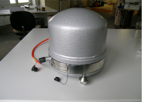

Picture 3: The pendulum
With the help of analogue electronics the three sensor signals are converted into values for the X, Y and Z axes. These analogue signals come via a cable connection into a digitalisation box that logs all data before forwarding it to an earthquake centre by radio, telephone or satellite link.
