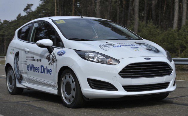

Ford and its technology partner, German-based automotive component manufacturer and supplier Schaeffler, have unveiled a Fiesta-based eWheelDrive research car, which is powered by independent electric motors in both rear wheels.

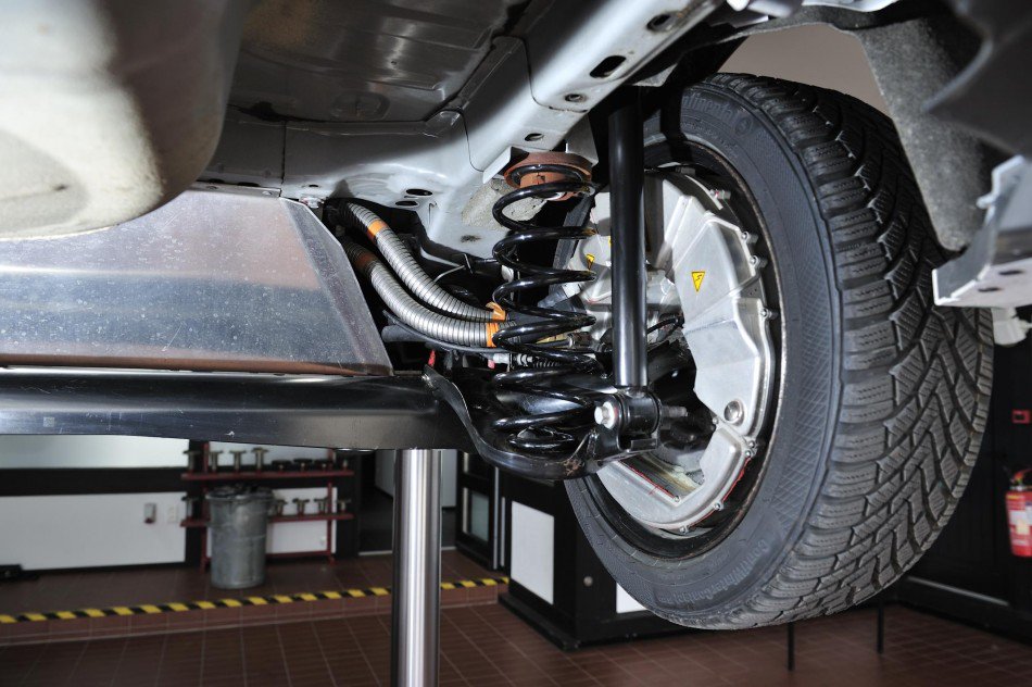

The integrated wheel-hub drive in the test bed demonstrates the potential of saving space by freeing up acreage under the bonnet that would otherwise be taken up by a central motor in an EV, and in a conventional car, by an engine and transmission and replace them with more space for features such as additional protection zones.

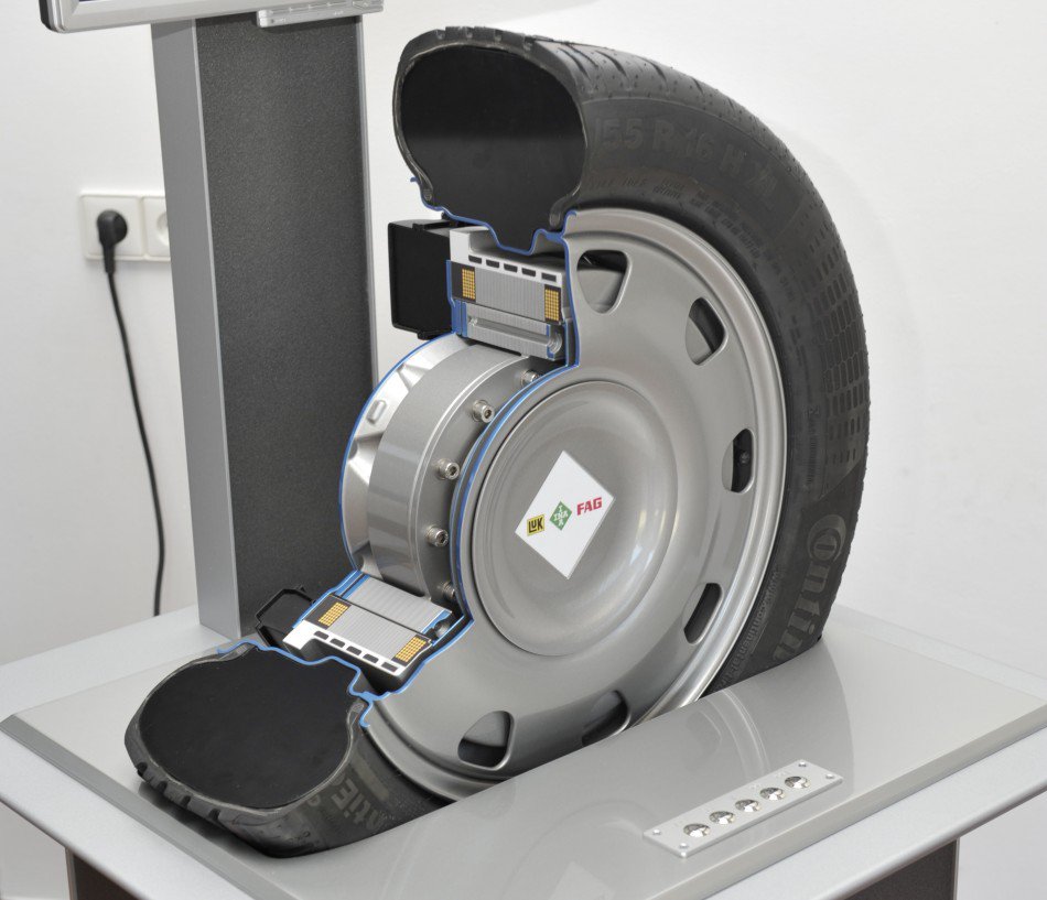

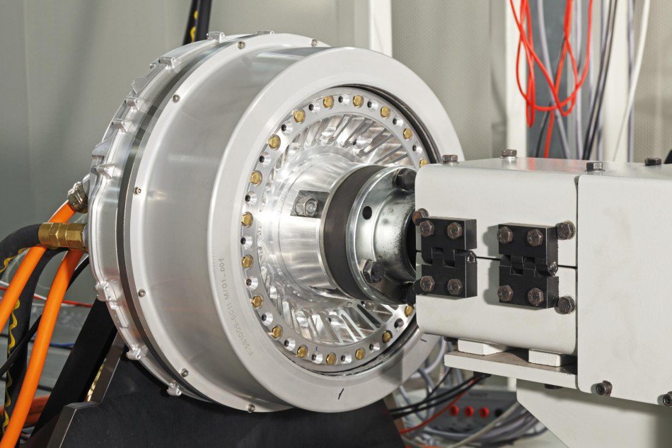

With in-wheel motors, the components required for drive, deceleration and driver assistance technologies are installed in an integrated wheel hub drive, including the electric motor, braking and cooling systems.
